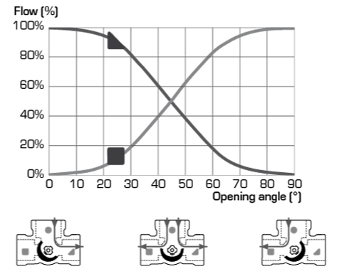

Types of 3 way diverter valves???
yep - certainly can be coupled with a VRG230 - a 3 port diverter/mid and as it's both a 2 point and 3 point then it'll give more flexibility, controls dependent.
I am not sure the mixer part is required with the ASHP installation but it looks like the right solution. I can see Daikin ASHP use the same valve.
Does the VGR230 have the same flow pattern that you wanted? Or can the user re-configure the valve internals to alter the flow pattern to suit? I didn't fully understand the video!
No! I need the VRG330 pattern… In the video they explain the flow can either come from the square or the triangle but not the circle. This is exactly what I need! The reason for the video was to share information with future readers of the tread…
