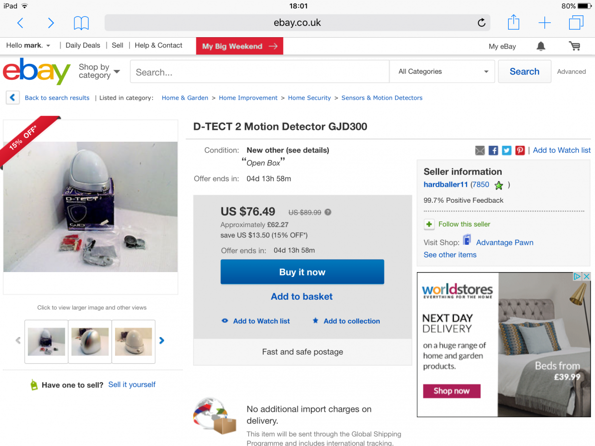

The Elite has two relay outputs that you can connect to your NVR and alarm system respectively. It also has the "A" and "S" outputs for interfacing to GJD's own Solitaire lighting controllers (you'd need a Dygizone keypad as well). The Solitaire will take care of the lighting side of it, it's a very good system and has built in chime etc. You can also output from the alarm into the GJD system to bring the lights on if the alarm is triggered. I would swing more towards the GJD D-Tect 2 PIR rather than the Elite, though. Just personal preference. It's a better sensor all-round.
GJD and elite sensor ....covers all bases , you can use a single or double zone controller to keep costs down depending on lighting areas or switching loads !

As it happens I am watching one on eBay now!
I will do a bit of research on his system.
It does say it's range is 8-30m, my drive is only 6m in length! I assume the sensor can be tilted downwards to make it more like 1-10m?
