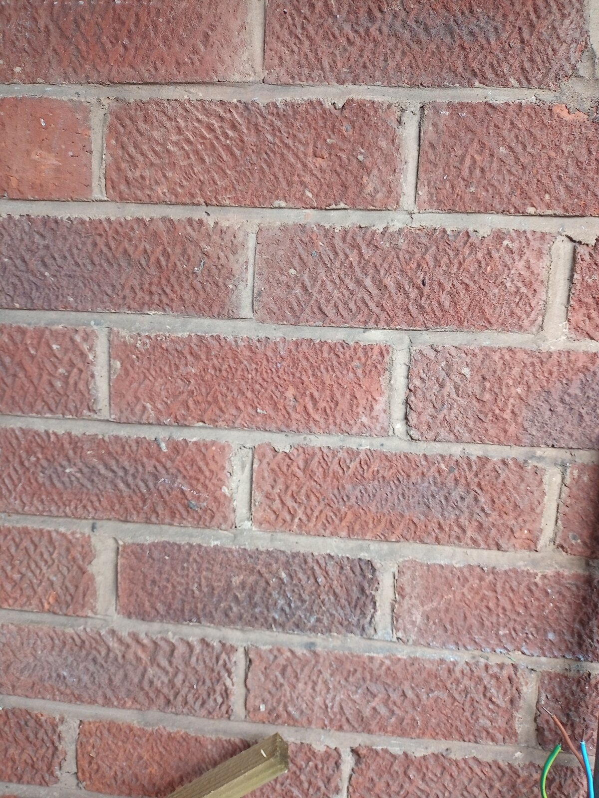

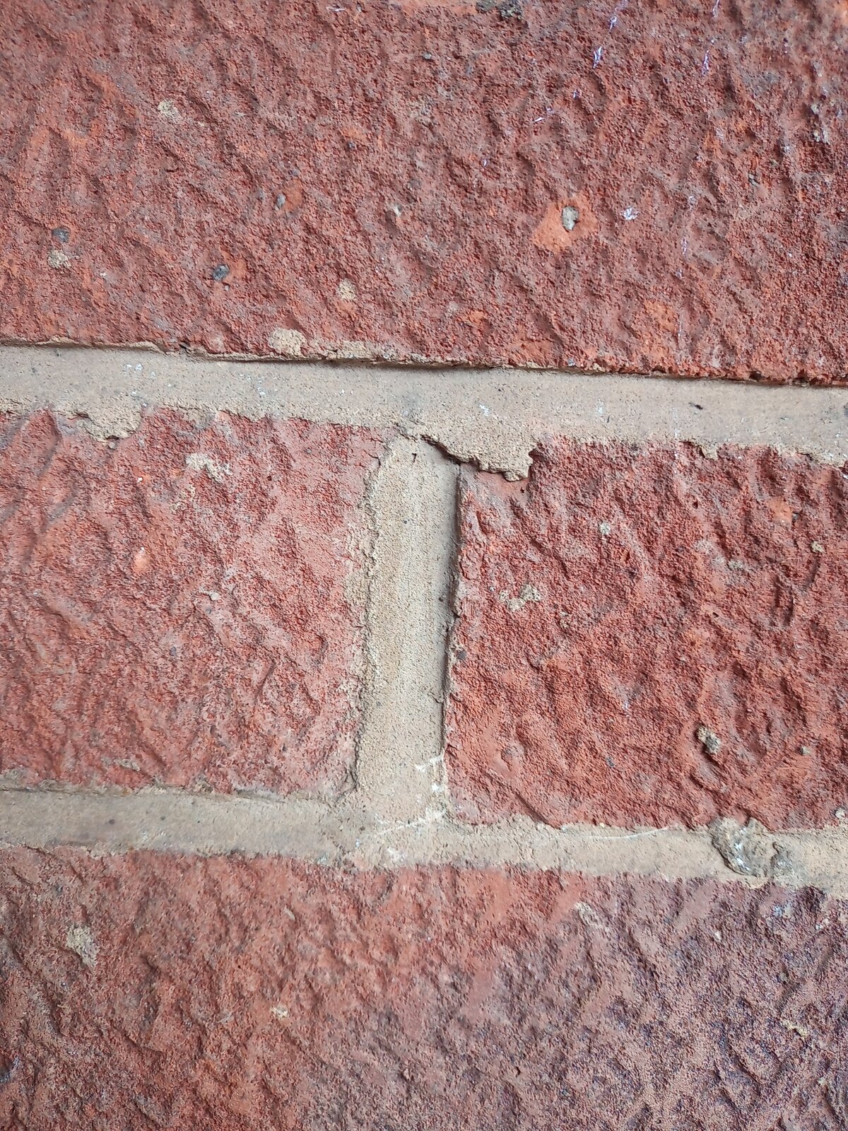

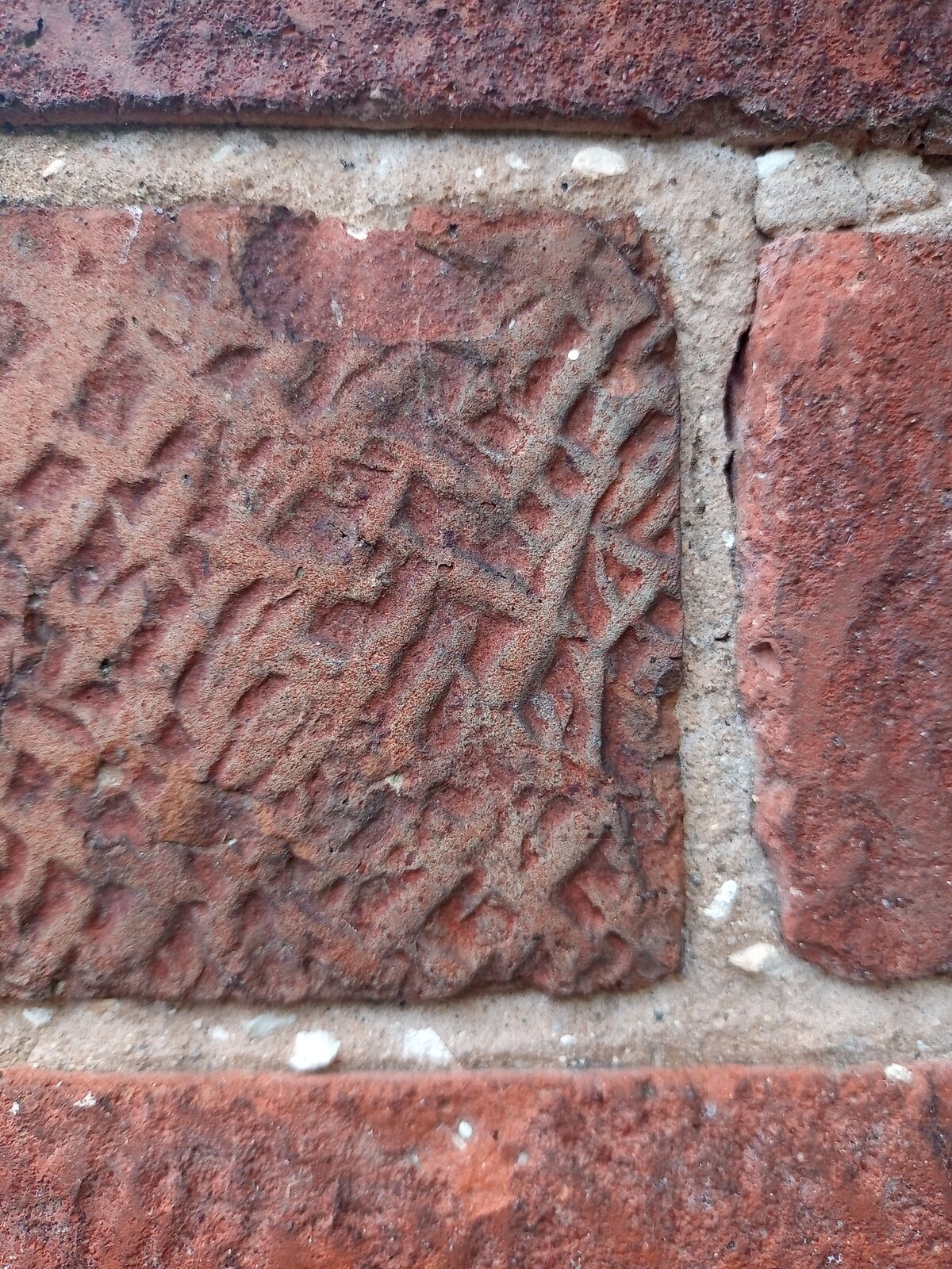

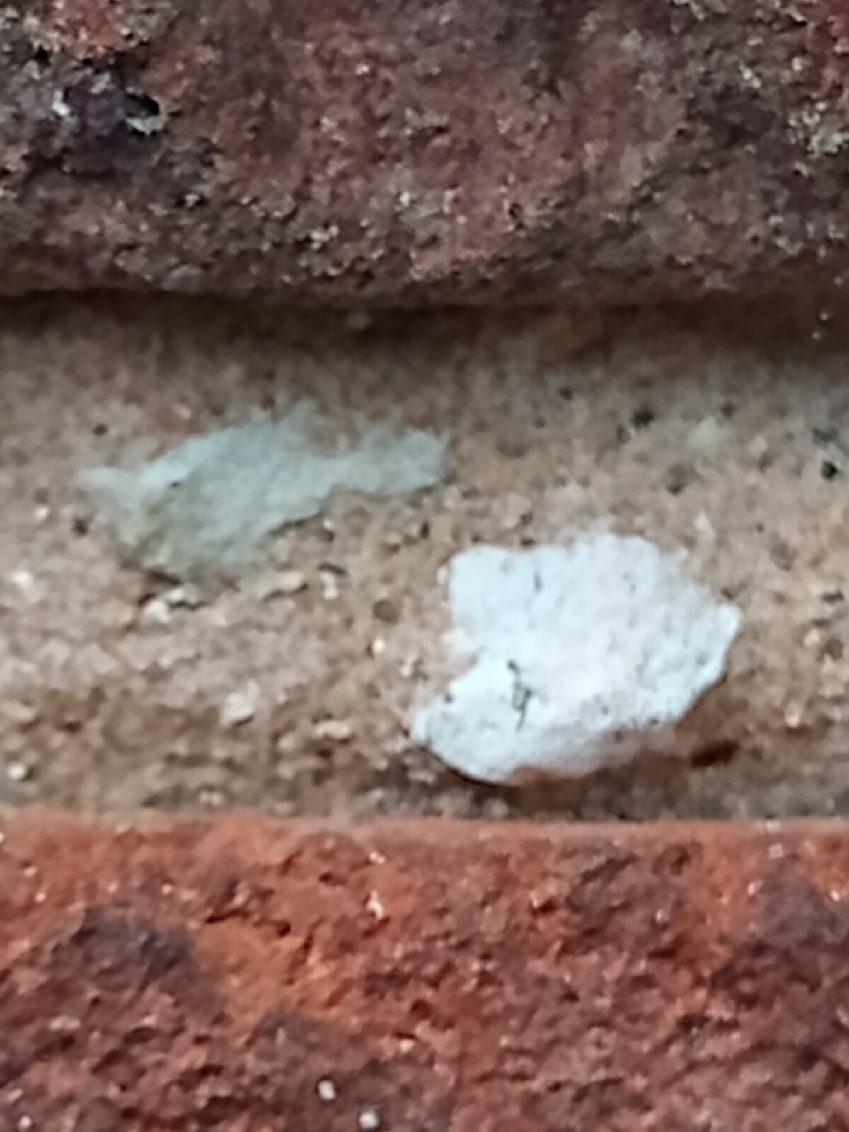

Hi just getting ready to repoint my house. I'm not sure if they've used lime mortar or sand and cement. I've attached pics showing white flecks in the mortar which don't really fizz when sprayed with white vinegar. Anyone got any idea?

Forgot to mention the house is made from engineering bricks in the late 1950s on a council estate. Any advice on what the mortar is and general repointing tips when the perp joints aren't uniform widths would be super appreciated.

Well the mortar doesn't really fizz when I spray it with white vinegar, there's a very slight almost not noticeable bubbling abit like something that's parched and soaking it up rather than a fizzing if that makes sense. So you may be right, bit of a tricky one, hopefully Woody will chime in......
As Charlie said, most 50's construction used cement mortar with lime added as a plasticizer. Sand/cement mortar is not very workable without lime or plasticizer added. Building sand looks like in the photo once the surface has weathered. A course sharp sand would be hard to work with.
those look like small lumps of neat cement - back in the day it was hand mixed -sometimes lumps would occur in the paper bags ( 1 cwt. each ! )
I'm leaning towards it being sand and cement. Internally the walls seem to be rendered in the same stuff with a smooth surface coating of what looks like cement to me. light grey in colour a few mm thick and easily cracked.
