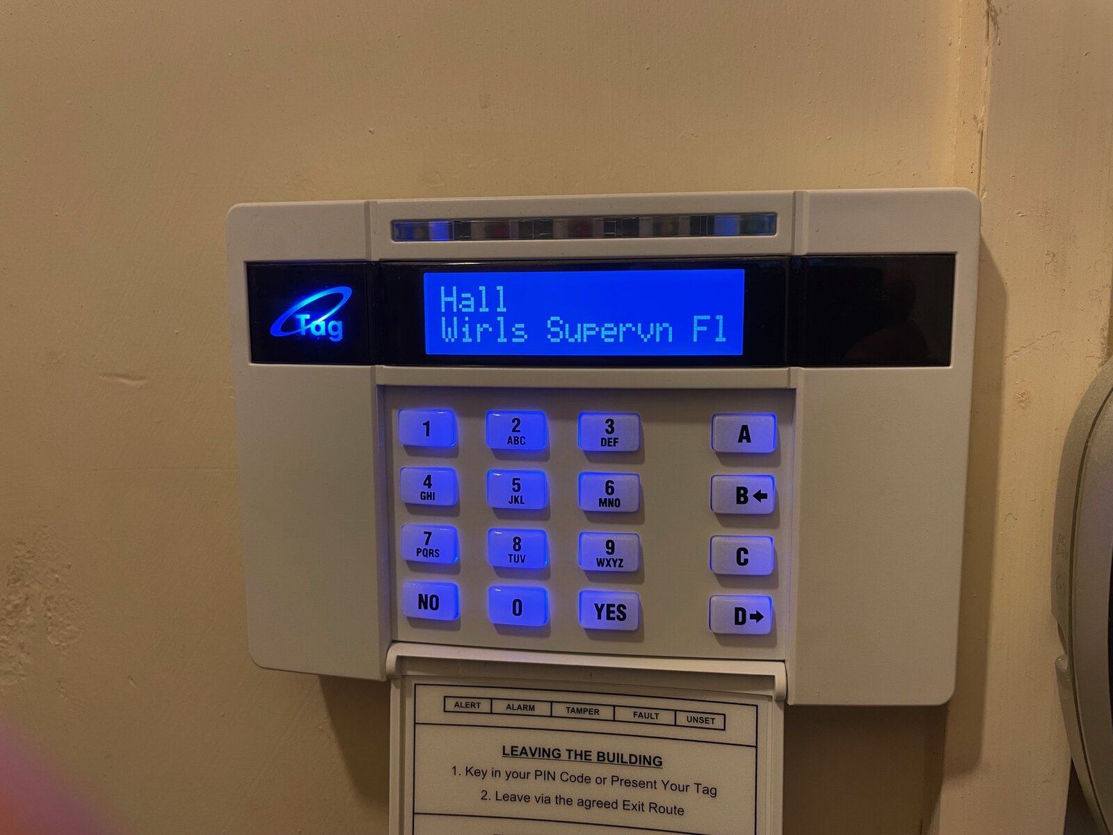

I have a problem on my Honeywell ADE Gen4 alarm system panel.
Standing fault "Hall wirls supervn F1". I'm noy sure if the sensor in my hall is faulty?

A ….It’s not a Honeywell system ….it’s either a euro 46 with wireless expander or enforcer with a keypad ….
B….the battery is probably flat in the hall sensor

All sensor batteries were replaced a week ago, as were the external alarm sounder batteries. Two batteries in in each paralleled for longevity.
It's possible one of the replacements is faulty, so I'll replace. it.

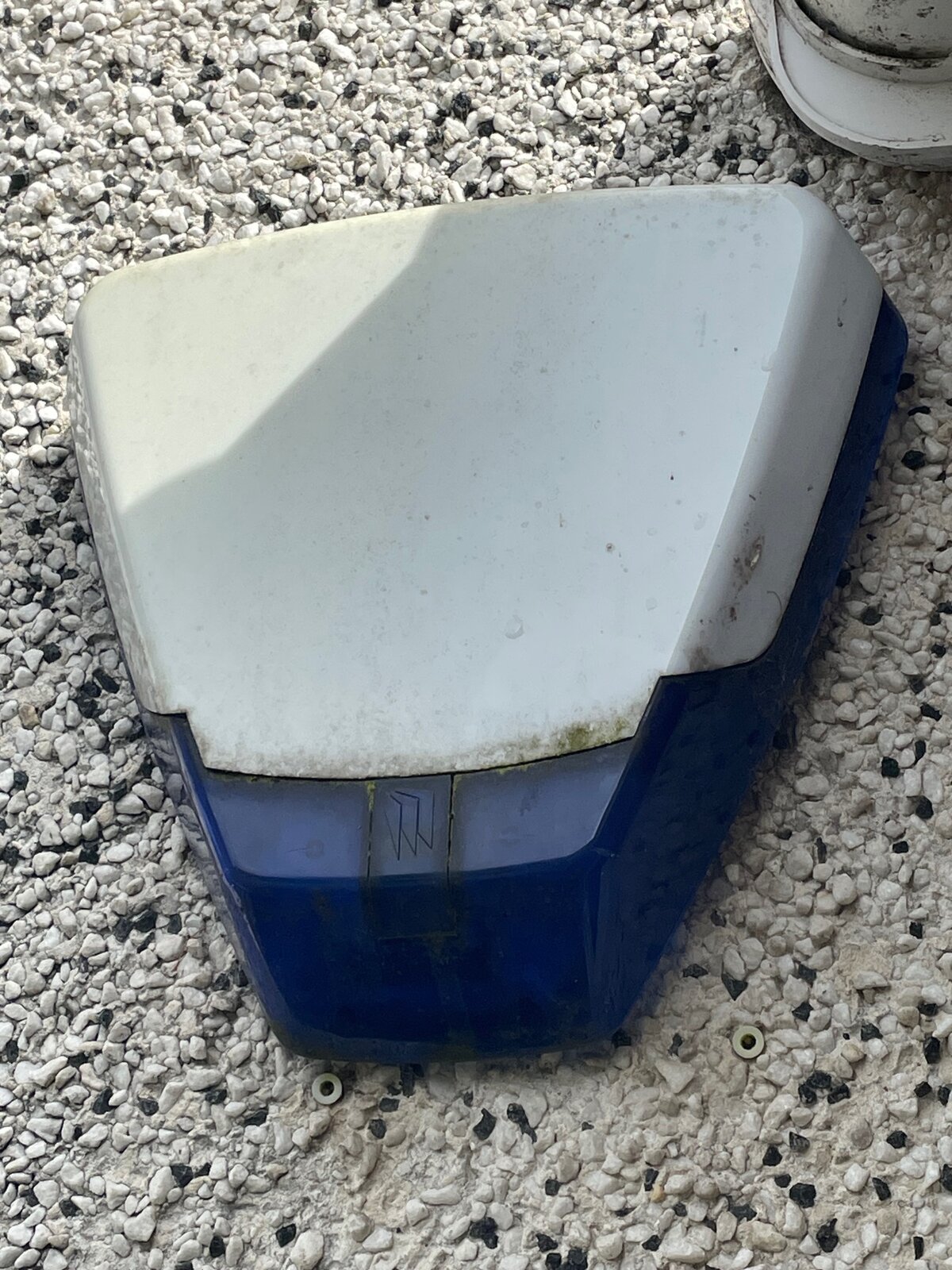

You can’t fit two batteries in parallel inside a device ….where did you get that from ?
Are you saying you can’t do this in the outside alarm boxes? Lots of room. If it wasn’t dark I’d go out and take a picture for you.
The external bell box is a Pyronix Deltabell. There is a logo bottom centre.
Originally there was only one battery pack, but as I mentioned it was doubled up.
The battery in my hall sensor was indeed faulty.
Replaced this afternoon and all back to normal now. Cheers
