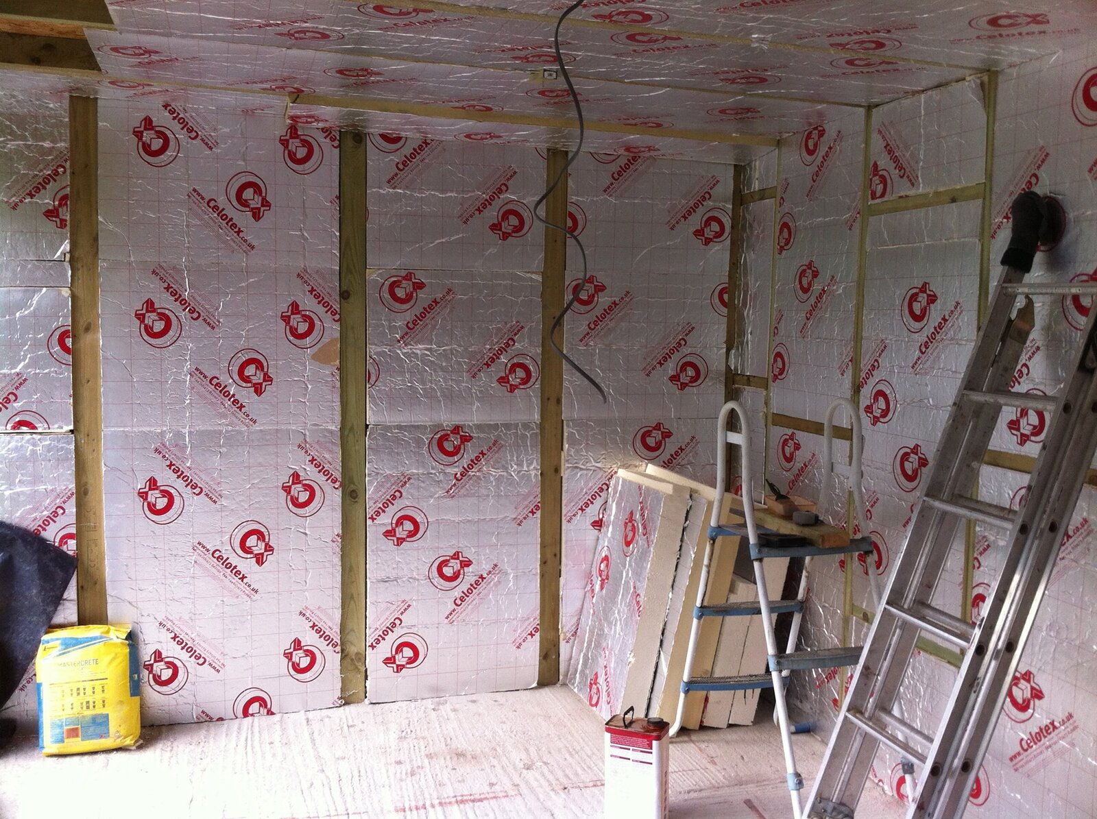

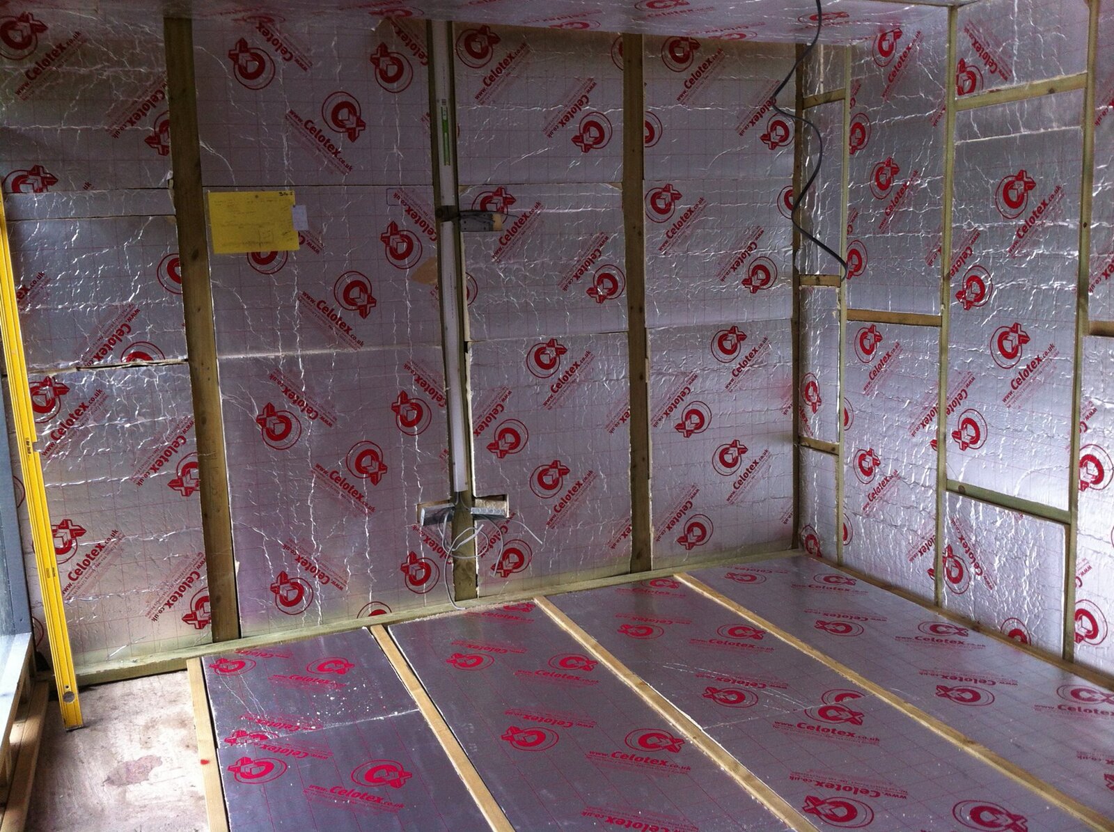

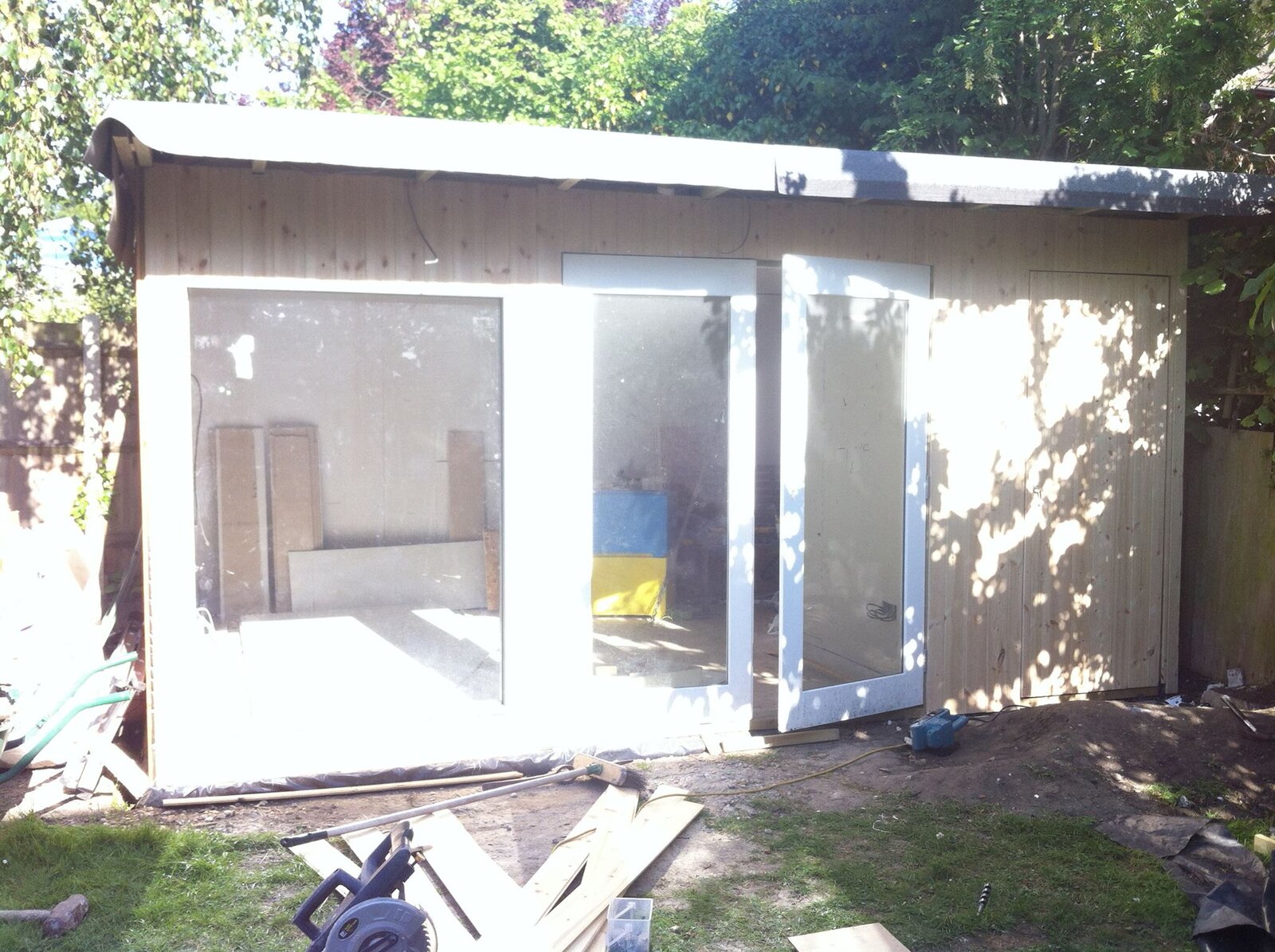

How big?

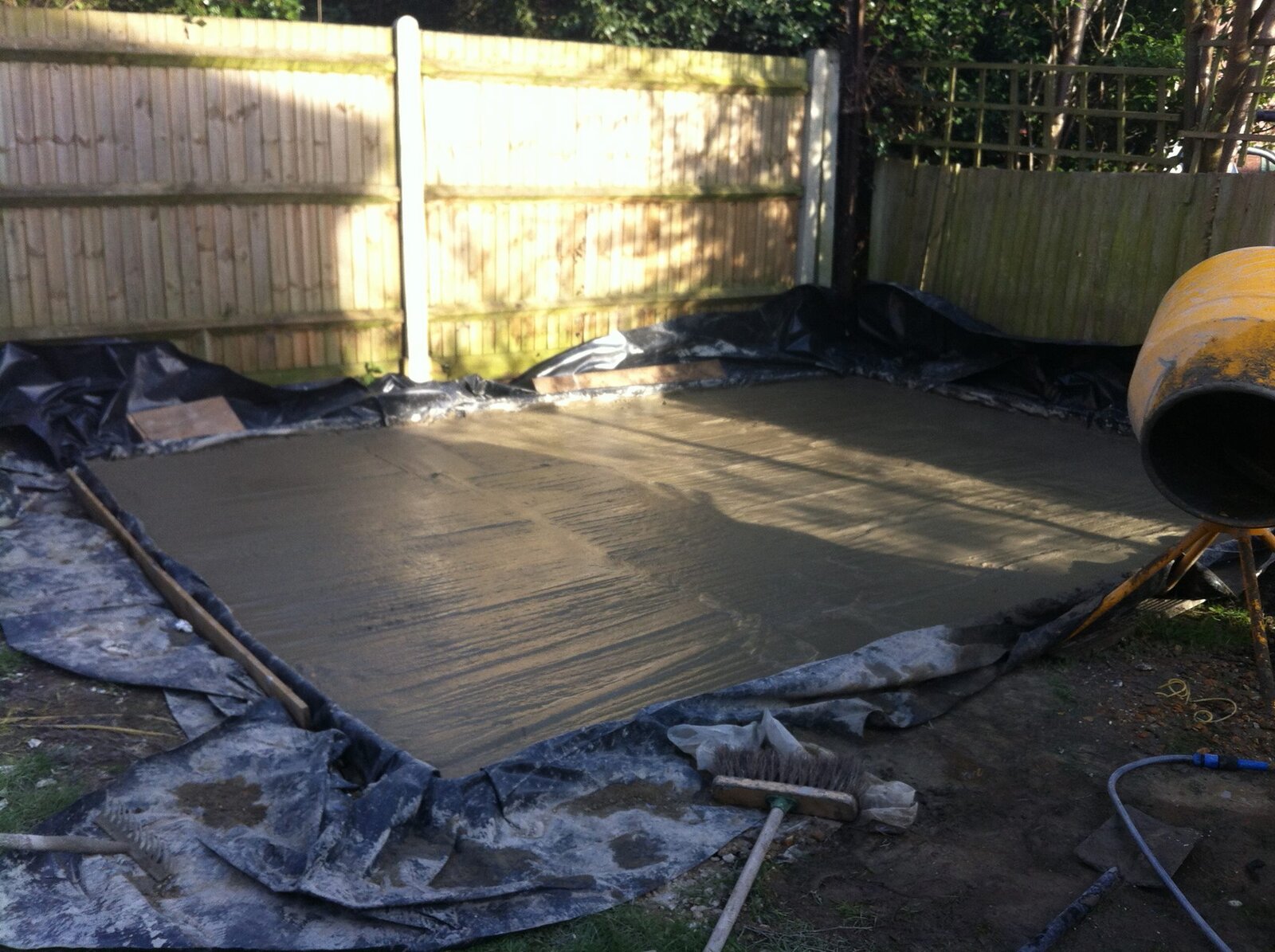

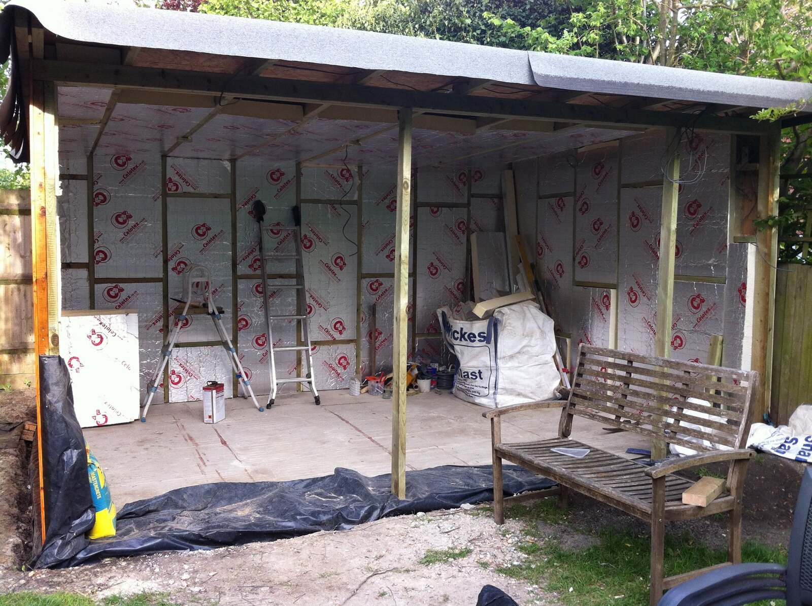

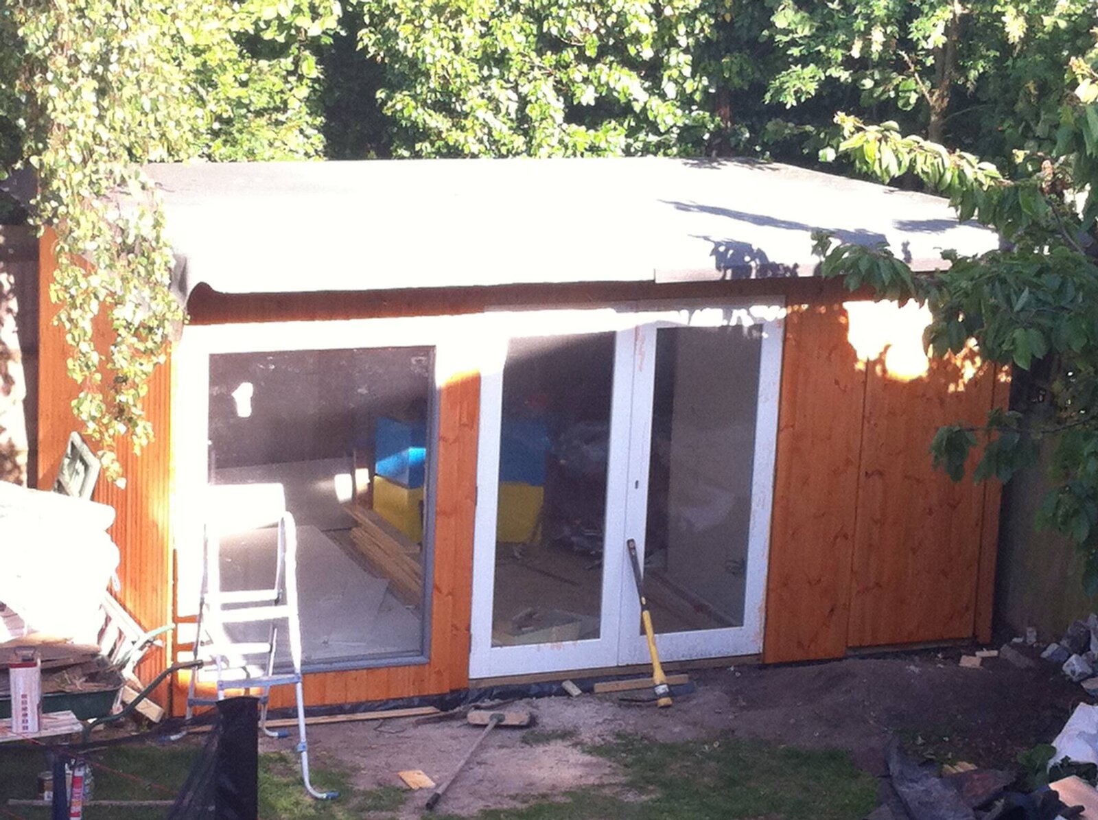

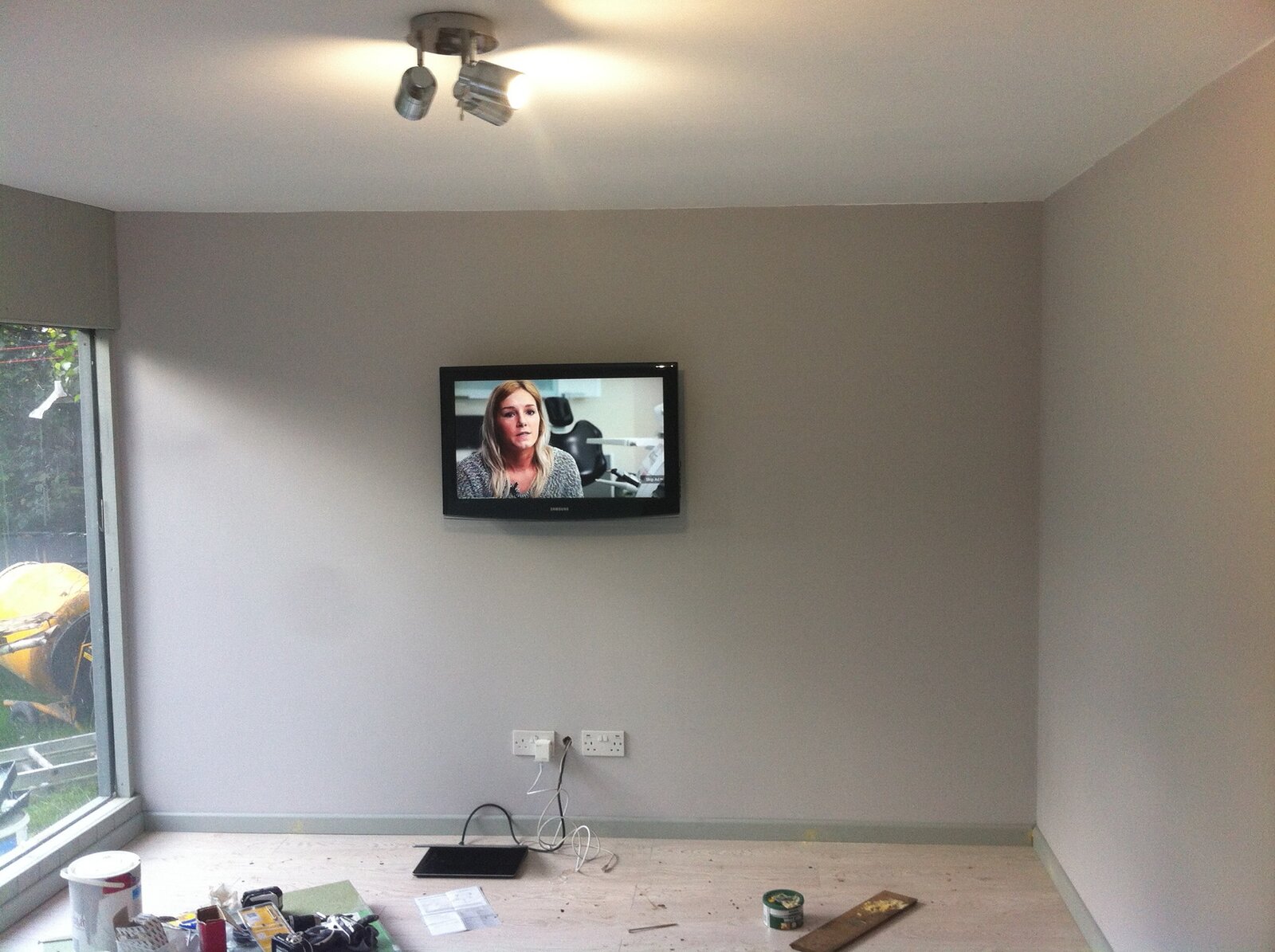

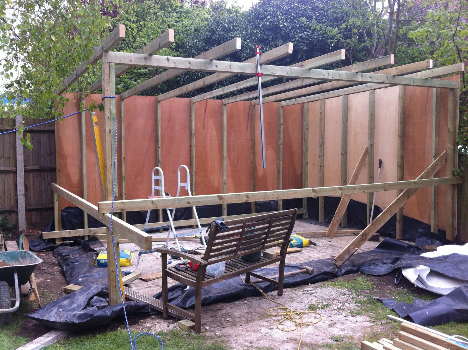

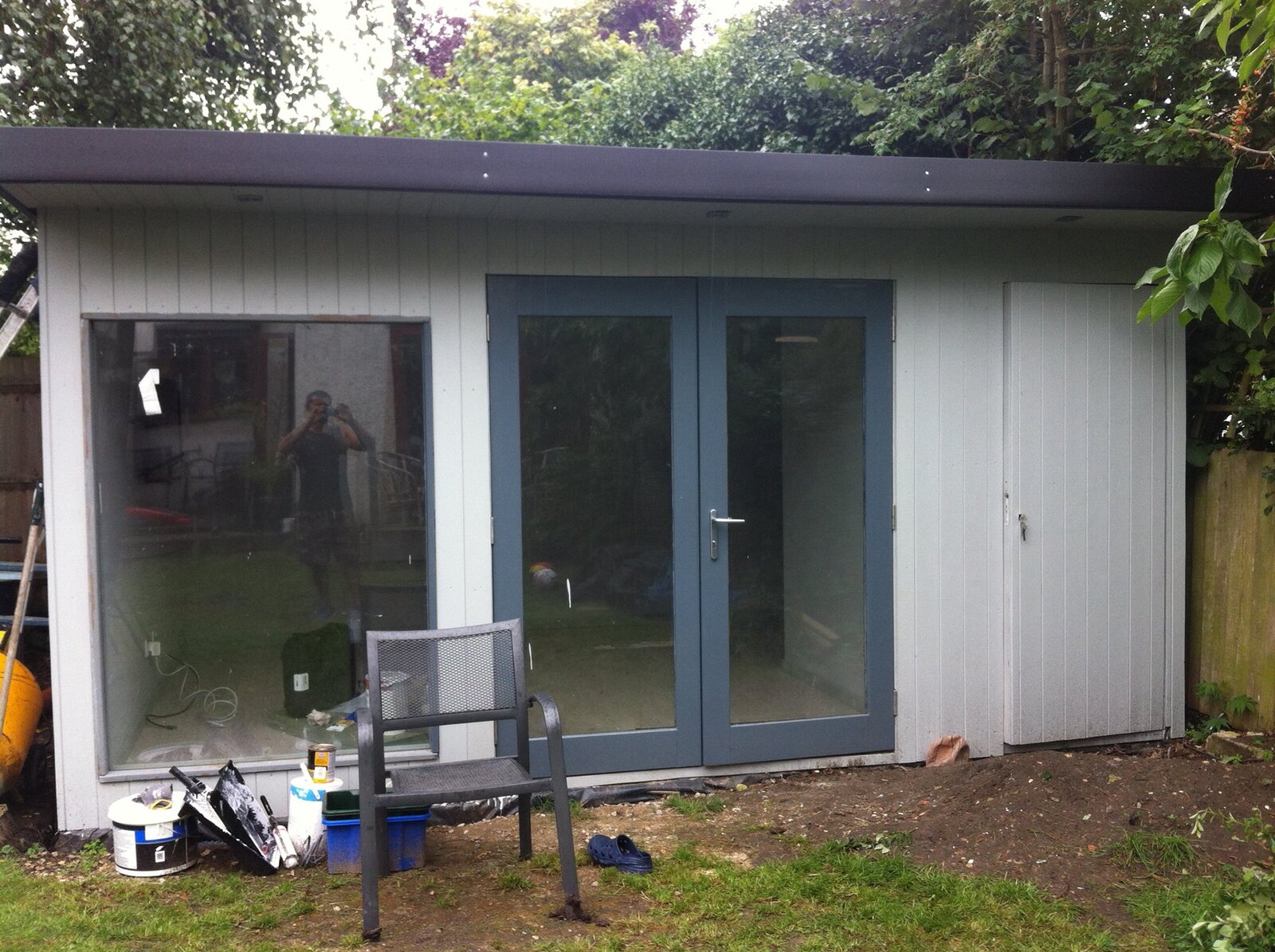

I built this for 4K - its insulated to 0.2 U with 100mm celotex in the walls and ceiling and 50mm + 100mm of poly in the slab. The roof is triple layer shed felt. Walls are timber frame + t&G cladding/marine ply in the areas you can't see.
Hi, it would be 4m x 3.5m. 2.5m height. For the ground, did you create a foundation or use floating rafter?
See pics below 15m2 just under so same size as you are thinking.. Slab was 150mm hardcore, sand, DPM, 100mm polystyrene and then 100mm slab and screed. Floor was 50mm celotex, everything else was 100mm celotex (benefit of hindsight 70mm celotex would have been fine and easier to fit in 100mm studs (which are dried to 95mm).
