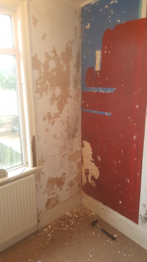

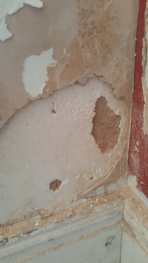

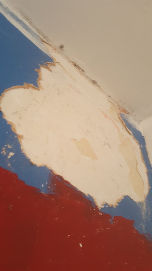

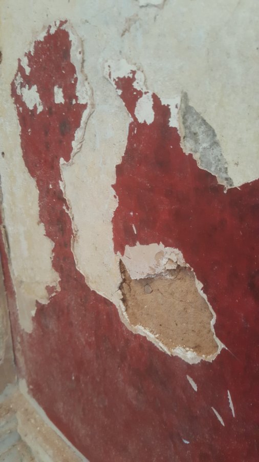

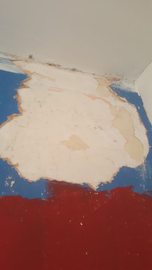

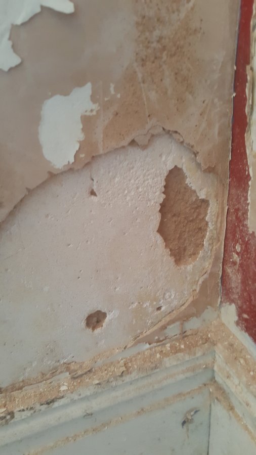

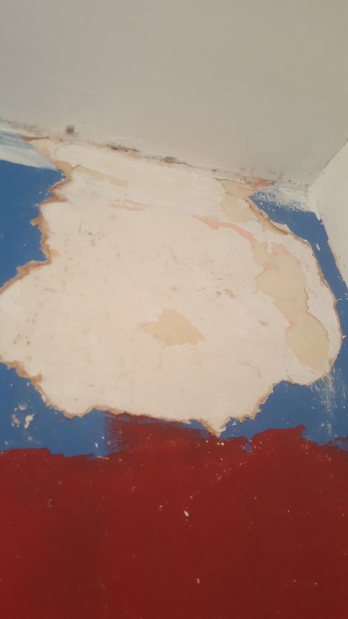

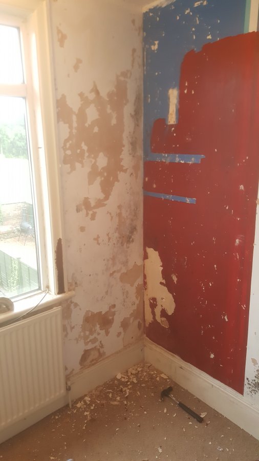

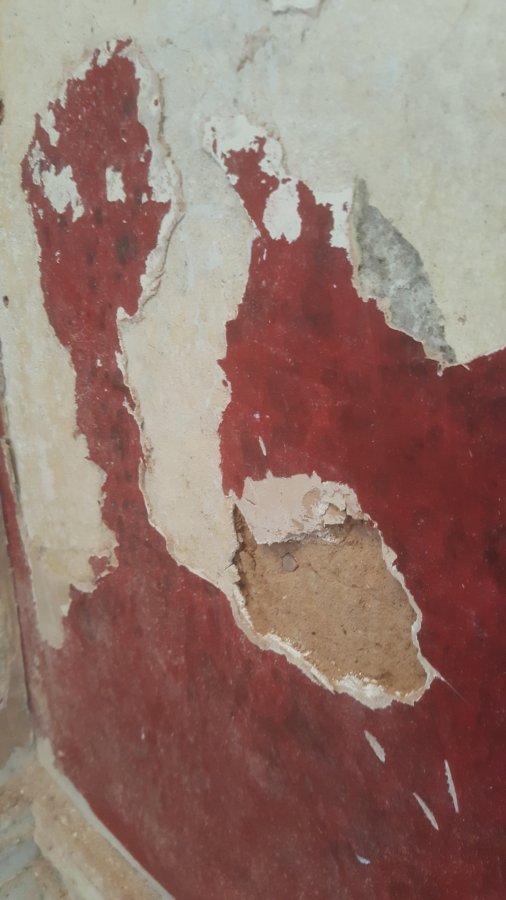

Hi, I am new to the forum.
I have very little DIY Experience but I have just inherited a 1920's semi detached so trying to fix it up.
This room once had damp/mould I think due to lack of ventilation.
I have kept it ventilated for a while now but when I came to strip the wallpaper. The plaster is loose and crumbling.
They are both upstairs exterior walls in the corners. I have removed most of the loose plaster.
My questions are.
1. How do I know if the damp has fully gone.
2. What's my best course of action on the plaster.
Pictures attached.

Hi and welcome, Wardy!
Always expect old plaster like this to come off in abundance......that's just what happens!
As for the damp situation, obviously we can't tell from here, although it would seem to be fine.
What's the condition of the roof, guttering, and so on above the suspicious area?
John :)

For sure, speaking as the worst plasterer in the entire world I'd get a pro spreader in.
Ask one to call and maybe you can do the prep work like hacking the old stuff off - again, he should be able to advise but it sounds like the whole wall will need doing.
Any current damp should be evident.
Good luck with your project!
John :)

OP,
The background plaster is crumbling - possibly due to excessive moisture.
You have indications of condensation (or perhaps damp penetration) where the ceiling meets the wall(s).
On the lower wall(s) you have skim finish over polystyrene.
In pic ...175 - If the crack in the upper corner is opened up and followed it might reveal a crack running down the inside corner of the walls.
OP, Go into the loft & investigate above the area in question. Look for damp.
External view photos of the two walls would help.
On the gable wall you might be best hacking off all plaster back to bare brick & then posting photos of any cracks.
Without seeing a photo of the window wall its hard to say what you should do.
Is the ceiling firm, smooth & crack free?
OP, Its not enough to just look up from below - someone has to go up to the roof & photo whats existing on the roof, chimney stack(s) and eaves, fascia & guttering.

Doesn't look like polystyrene to me , looks like previous repairs a 20s house wouldn't have originally been plastered with gypsum plaster.
But I disagree, plaster that old does fail without there being damp involved but if they are exterior walls then they won't be lath and plaster and can be very susceptible to failing due to damp. Look outside for signs of water staining to the walls , leaking gutters etc and see if the walls are actually damp.
Either way it looks as if its time to strip that lot back to brick and start again, you will then know for sure whether there are any damp issues
