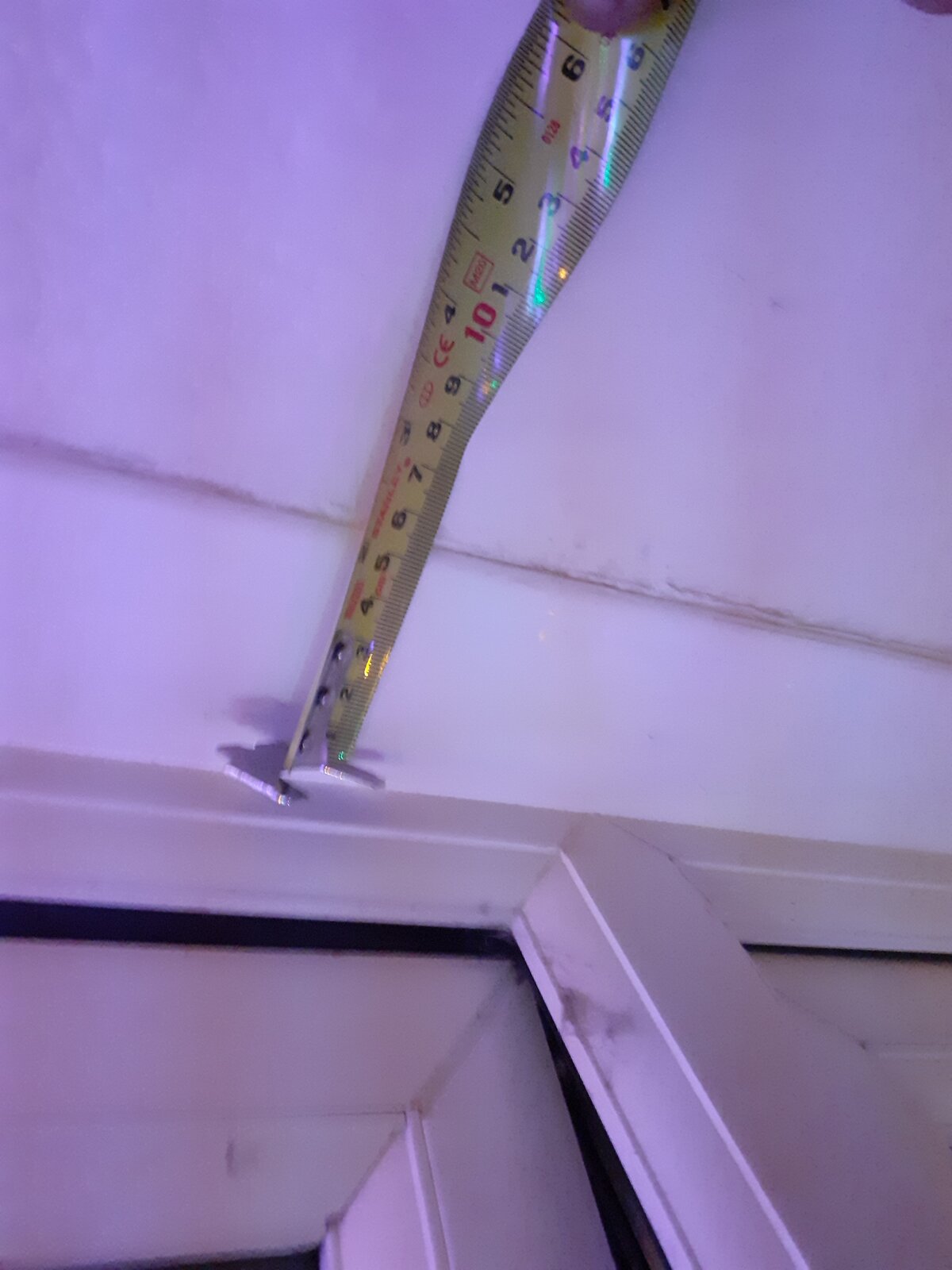

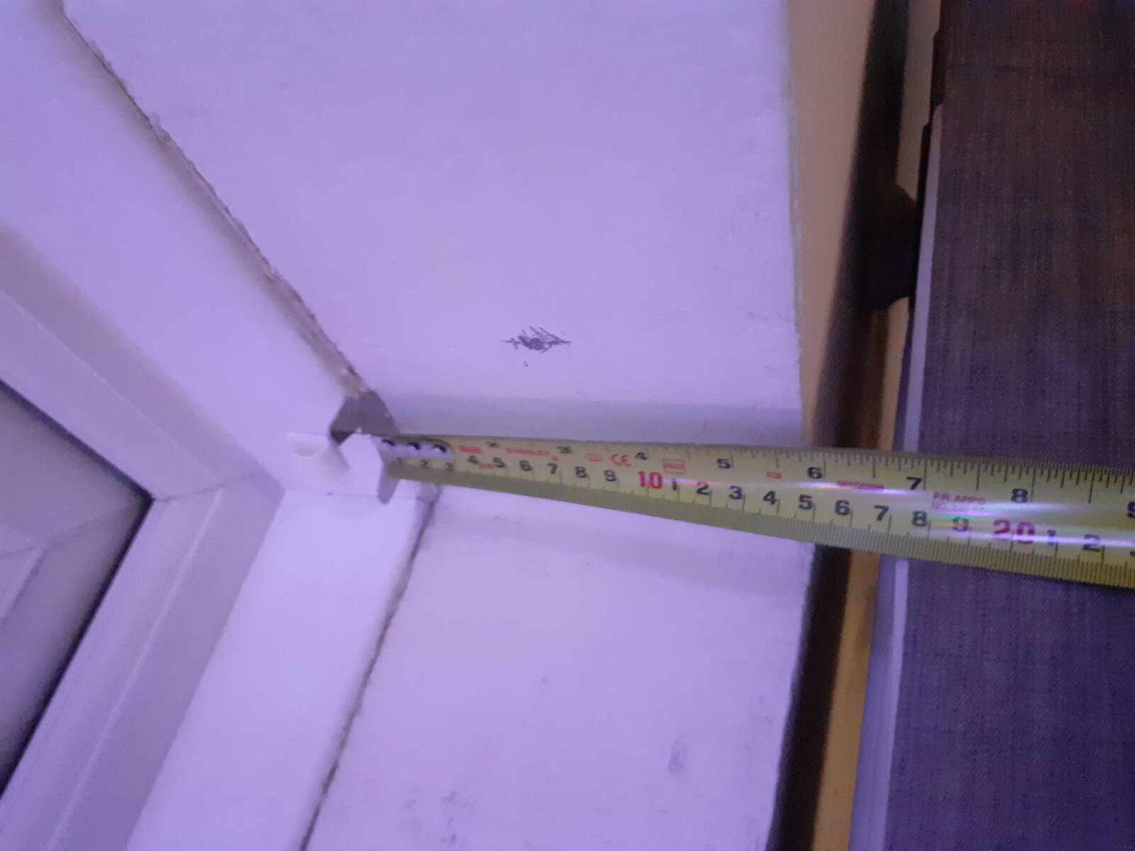

Put up some vertical blinds (65mm out from pvc). Is it best to put 5cm on end of pvc then measure to 11.5 or measure from metal tape end. I ended up using imperial (2.5inches) in the end because it was easier from that side of tape at the awkward angle.

When measuring and marking a flat surface you would get on better with a steel ruler like this:https://www.screwfix.com/p/magnusson-ruler-12-300mm/5850v Various lengths are available. You can measure and mark from the end of the ruler whilst holding it flat against the surface that you are marking.

The measuring for the blinds bit - in awkward situations like that I may cut a bit of wood or cardboard to the 65mm then use that as a template to mark from - but I would also put more care into keeping the distance from the inside of the wall to the holes the same, as this is the side that any inaccuracies or squintness wil be seen from.

5 + 11.5 is 16.5 not 65 unless I have misunderstood your calculations. Double sided metric tapes are available.

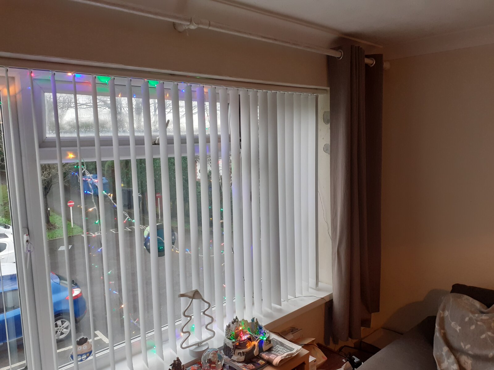

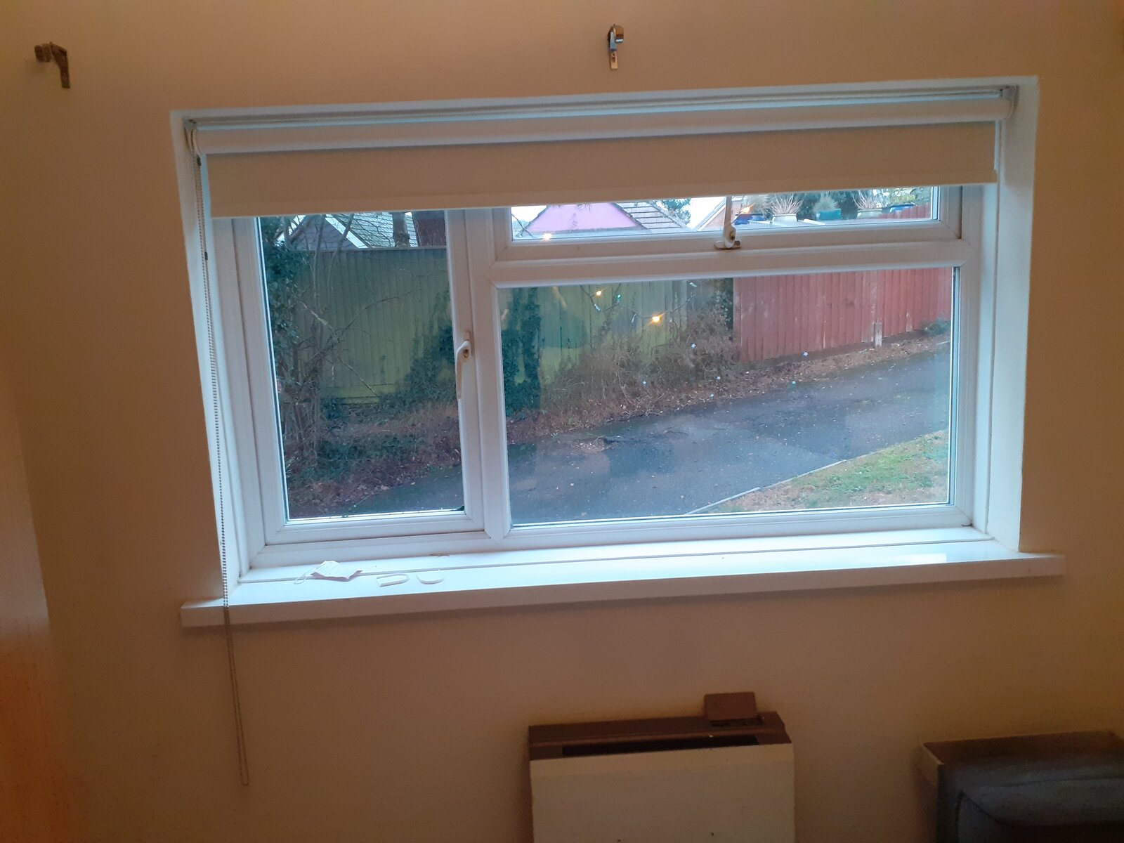

Might have been a bit out with measuring but got it up. The window reveal at the top is 10mm different at the ends

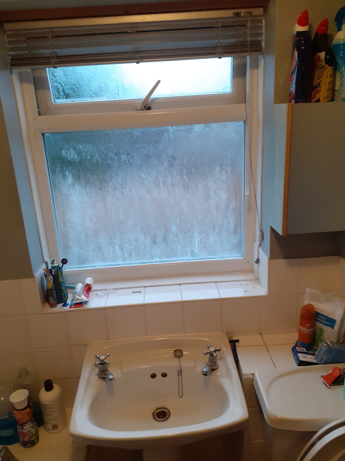

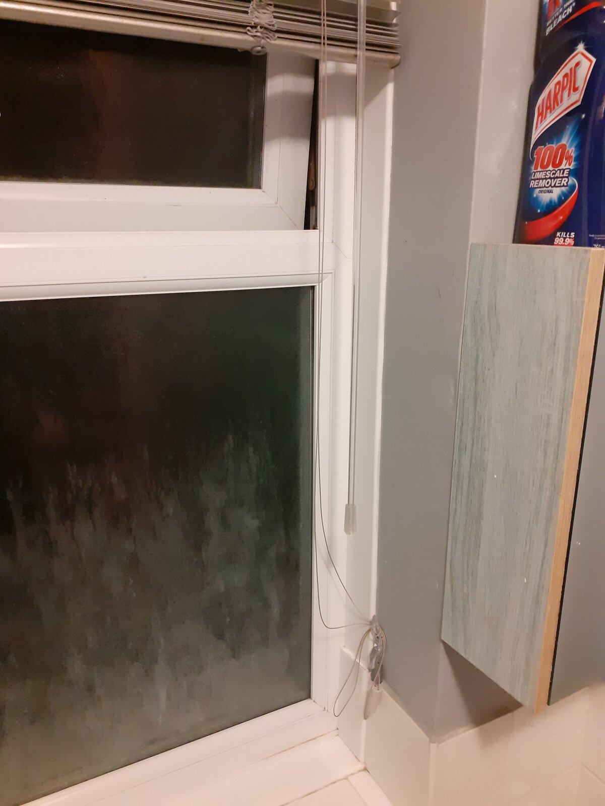

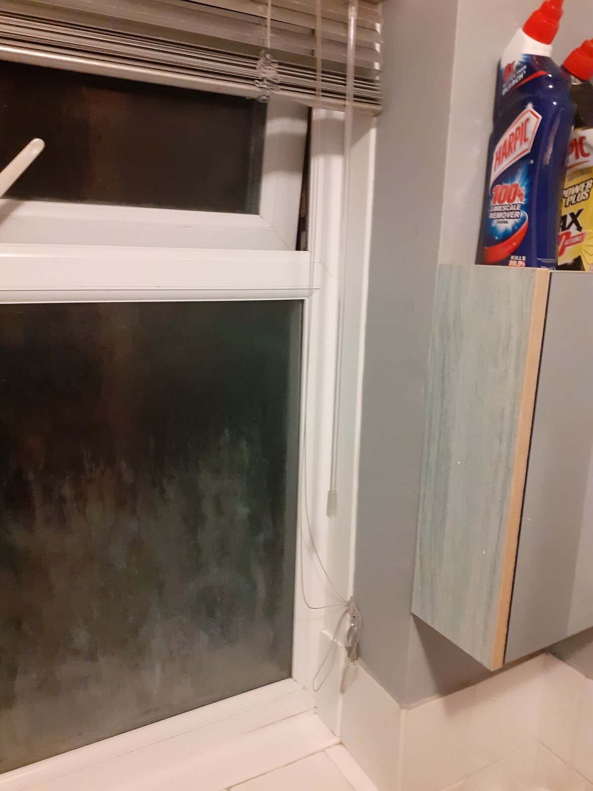

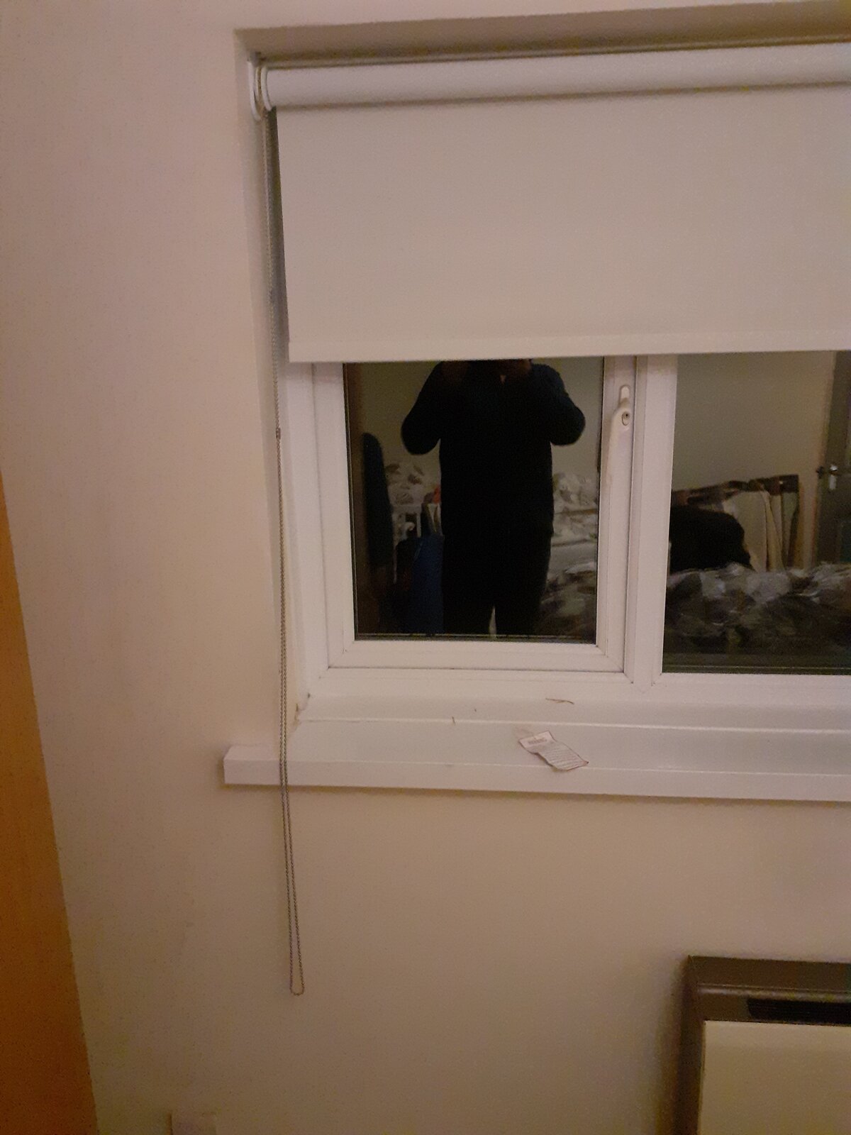

Regarding the cords, the roller blind one hangs really low and I've wrapped the Venetian cords around a wall tie two thirds down
Have you fitted the blind safety devices which are designed to prevent children from hanging themselves on the blind cords/chains. If you installed the blinds you are legally responsible for the safe installation of them. Normally blinds are supplied with a tensioner or cleat to fit to the wall for child safety purposes. See here: https://www.gov.uk/government/news/check-your-blind-cords-and-keep-your-home-safe
"Fit a tidy, tensioner or a cleat: tidies and tensioners should be firmly fixed to an adjoining surface so that the cord or chain are permanently held tight.
Cleats should be positioned out of children’s reach on an adjacent surface, at least 1.5 metres from the floor."
Chains and cords can be shortened. It is really important that you get this right. Children have died from getting caught in these cords/chains.

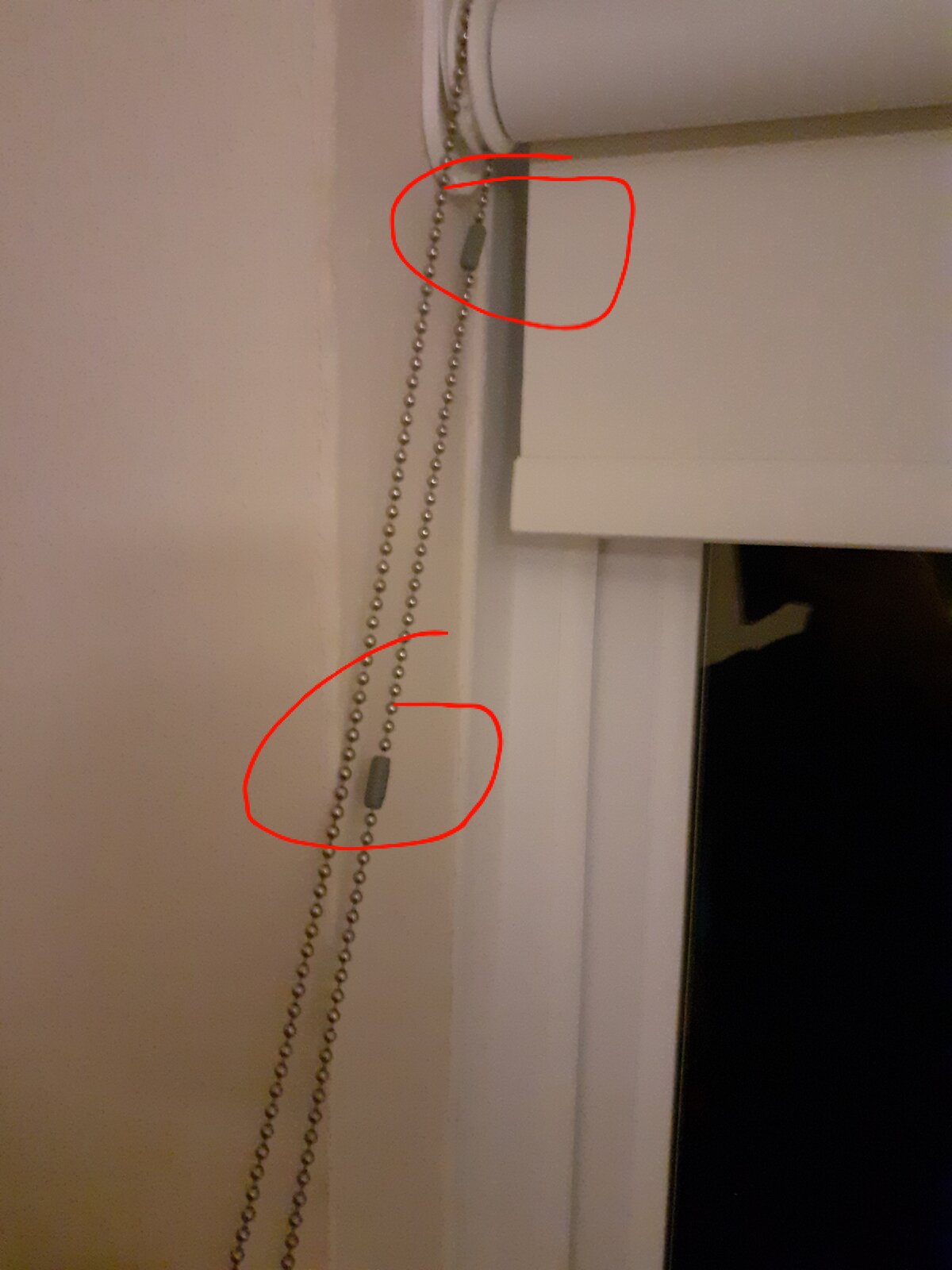

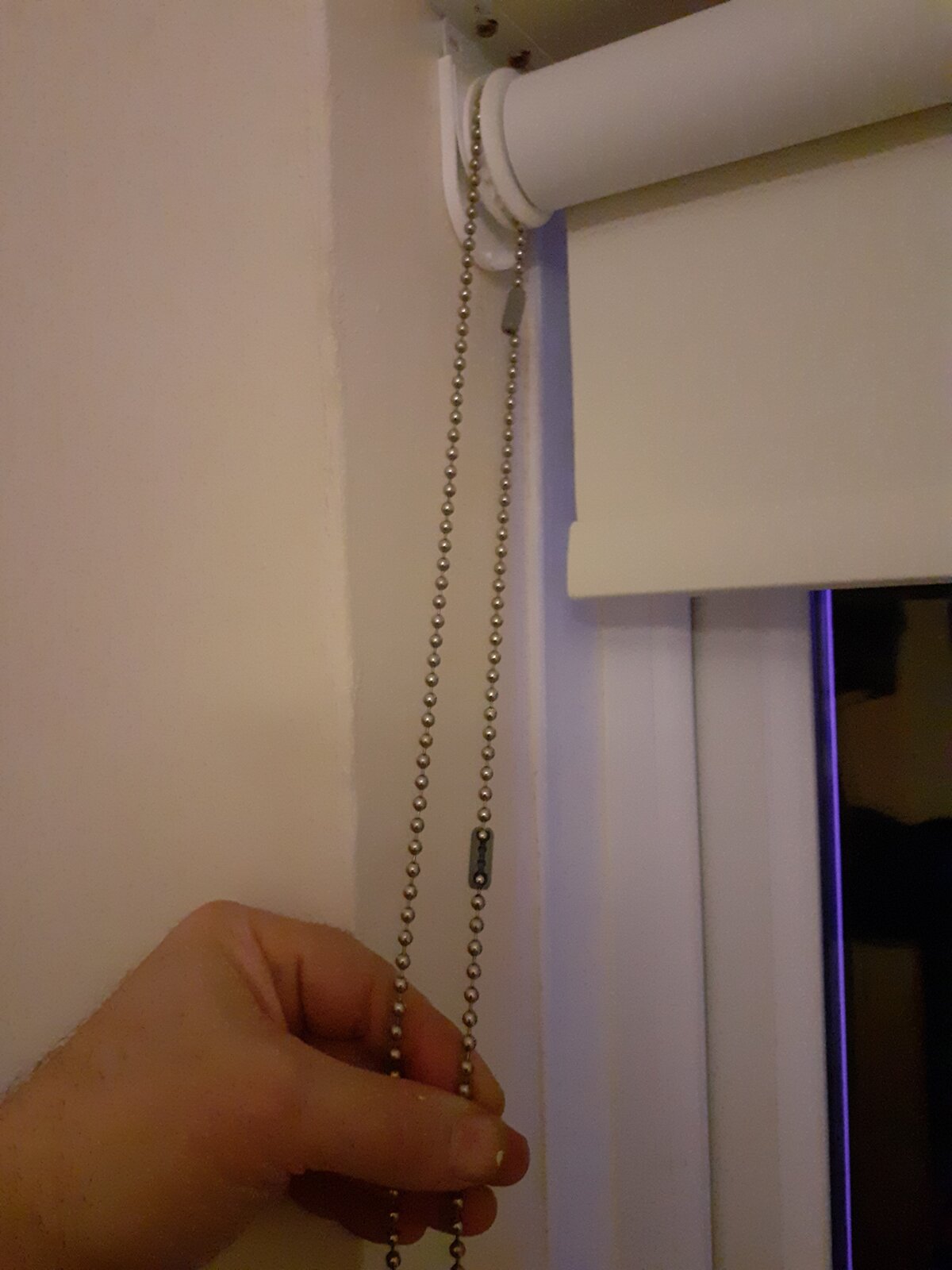

Does this look safe enough? Dunno why roller blind cord hangs so low though. My kid's seven now so past hanging himself I hope

Those loops you have circled are to allow you to shorten the pull cord/chain. If you set them correctly the chain should not hang lower than the blind when it is in the closed position.
Regardless of how old a child is you have a legal duty as the blind fitter to use any safety features that are supplied with the blind. If a cord restrainer was not supplied you should source and fit an appropriate one.
