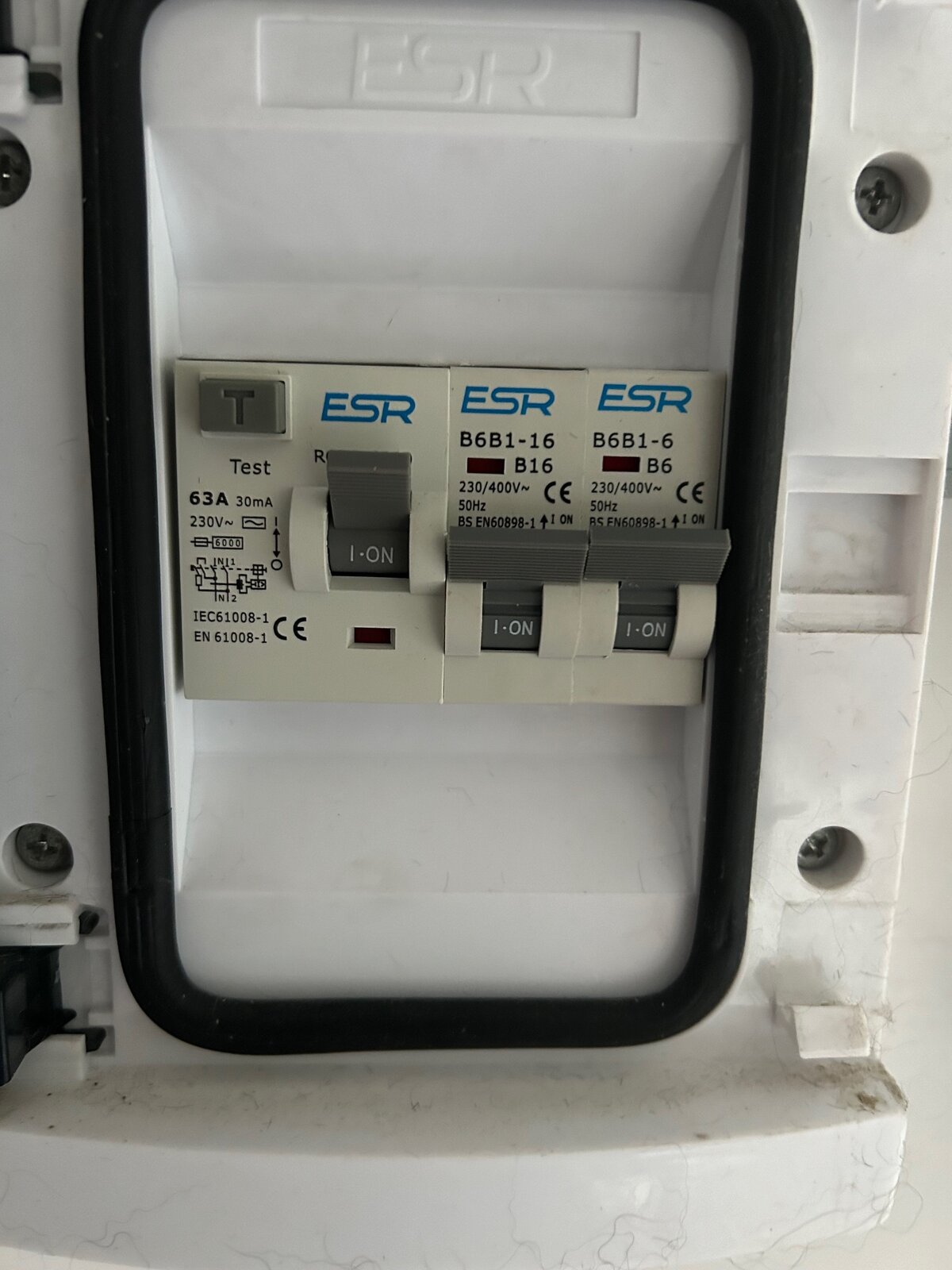

Hope someone can shed some light on this please.
My daughter runs a dog grooming van and has an issue with a 13 amp 'heavy duty' 3 pin plug getting hot and sometimes blowing the fuse.
This tends to happen when she is using a dog drier which has a rating of 2400 watts.
The van has the circuit breakers in attached pic, then the 16 amp plug and lead is plugged into the socket outside the van, this terminates with a 13 amp 'heavy duty 3 pin plug which is plugged into the customers home, it is this plug that overheats andblows the fuse occasionally.
I opened the plug and inside I could see obvious burning at the live connection, I rewired a new plug ensuring that terminations and 13 amp fuse were secure. I told my daughter to ensure that nothing else is being used to draw current while using the drier and after a while the same thing has happened.
The drier is now not being used until we can find a solution; from what I've been able to find out, the 13 amp plug should be able to handle a current draw of 2400w, is it possible that the length of continuous time that the drier is on would cause this?
Any advice or ideas on how to overcome this would be appreciated.

There's a 16A breaker for power and a 6A for lighting.
What are the other loads being used?
It would be interesting to do a current check with a clamp meter to see the load at any one time.
There are no other loads on at the same time apart from the internal led ceiling lights with amount to 35w. The van has a bath heater and shower pump but I made sure that she has these switched off whilst using the drier to reduce any excess current draw.

I would check there is definitely nothing else drawing current at the same time, no lights, no water heaters, as well as fit a good quality, well terminated plug.

Other factors could be the length of time the heater is on for, the quality of the plug and its connections and the quality of the socket and its connections.
Length of time was a thought that I had although the van was professionally converted and should have taken that into account. The plug is a screwfix 13 amp heavy duty affair and I terminated it myself and whilst I'm not a spark, I am confident that at least my fitting is good. Maybe the plug is not so heavy duty; any recommendations on a more suitable one?
If this is the Screwfix heavy duty plug you are using then apart from the plastic casing which does look a little more robust than a standard whit plug I wouldn't think it is particularly heavy duty. I think you need to look for something a bit heftier on the connection side of things including the prongs.
Post a photo of the plug, with the top cover removed, so we can see the terminations. A weak point of 13amp plugs, is the fuse, and how the fuse makes contact in the plug. You need to ensure it is tightly held, to minimise resistance heating.
