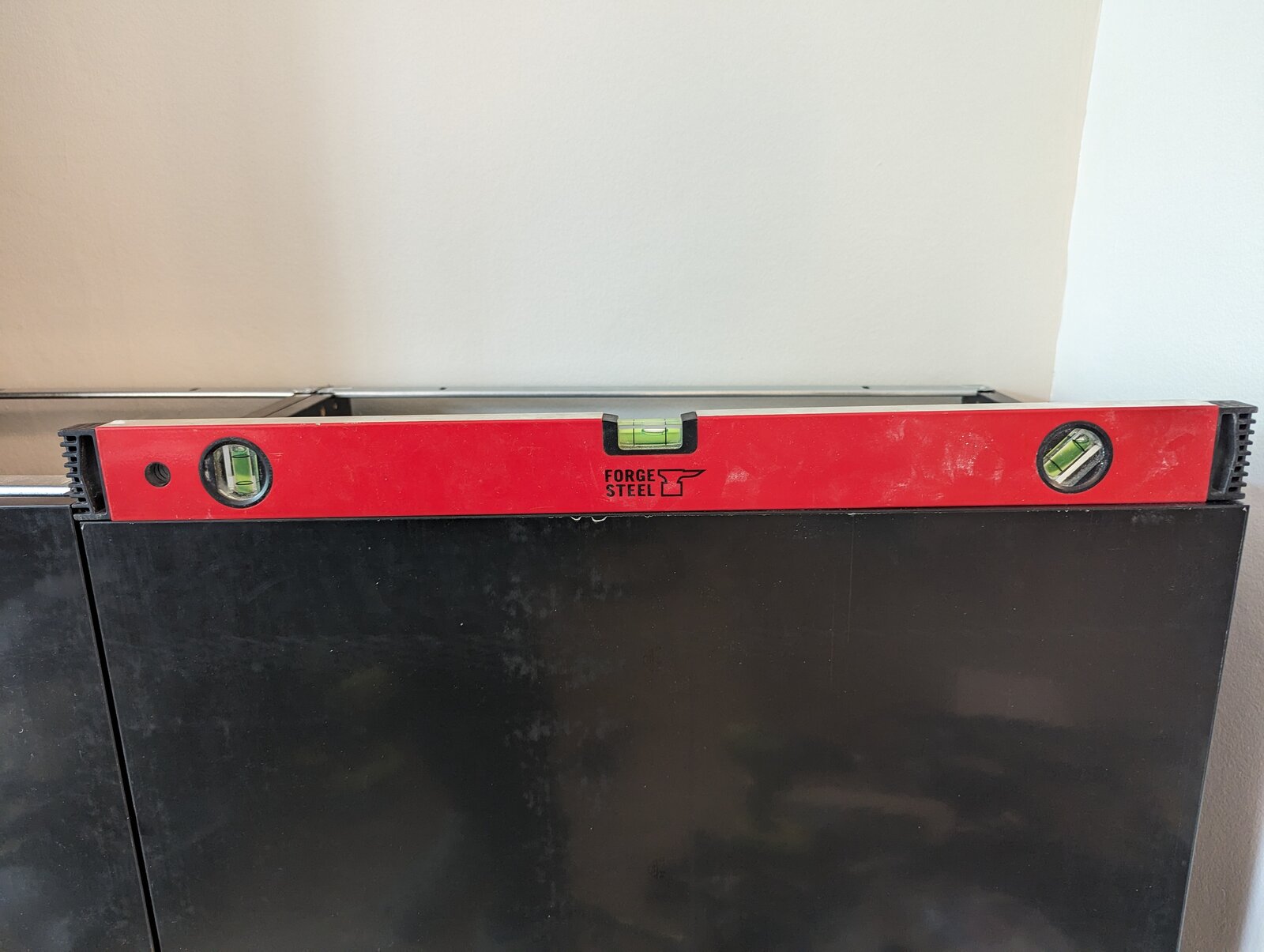

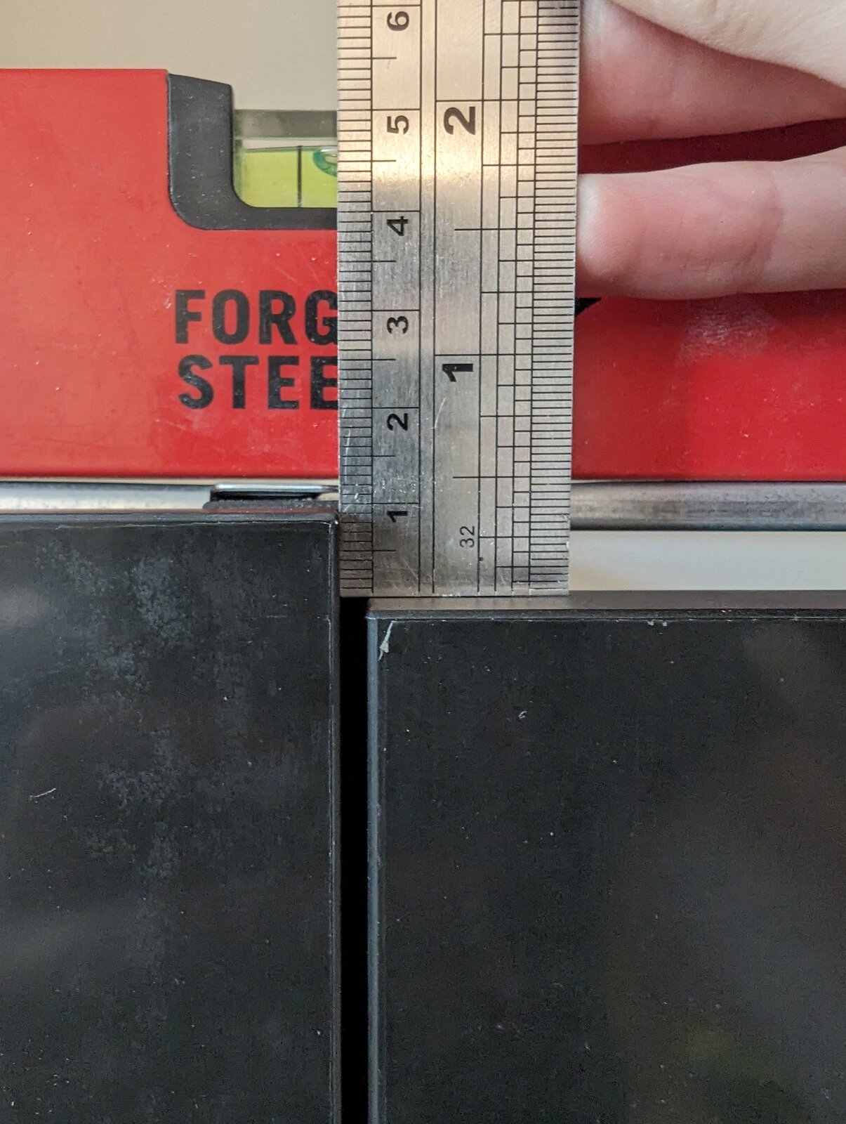

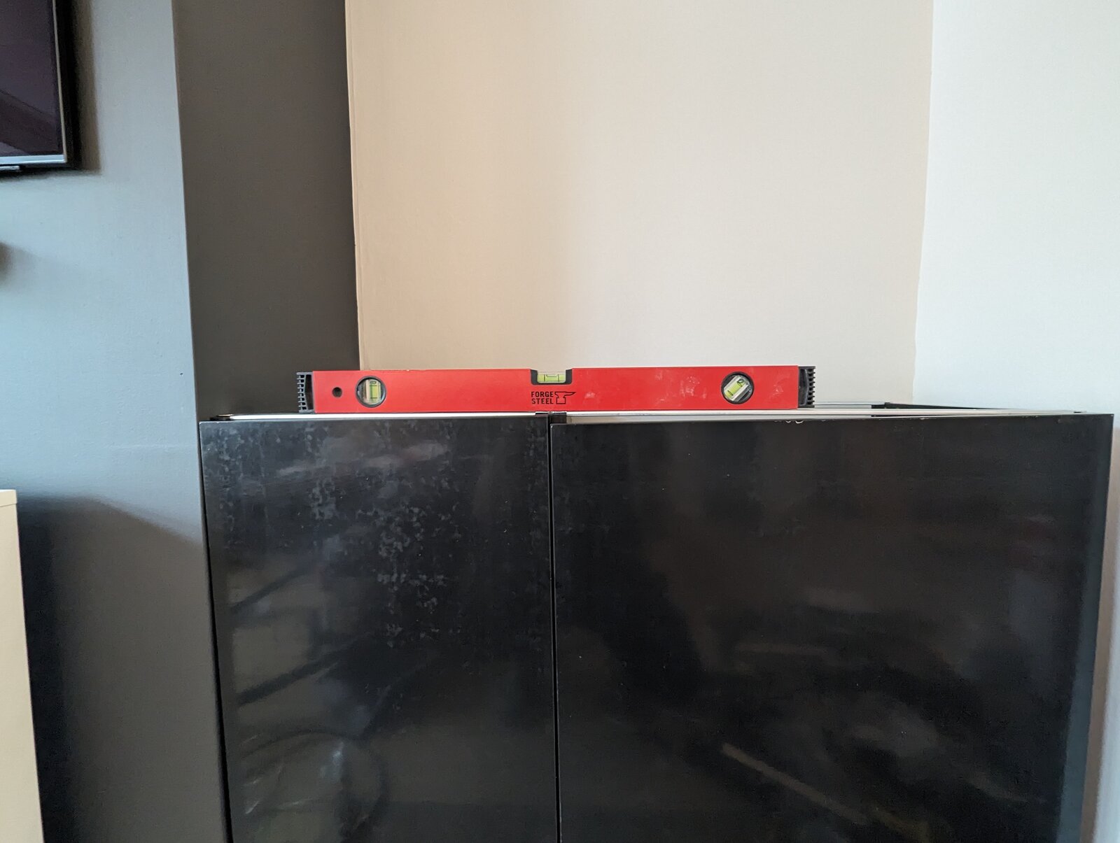

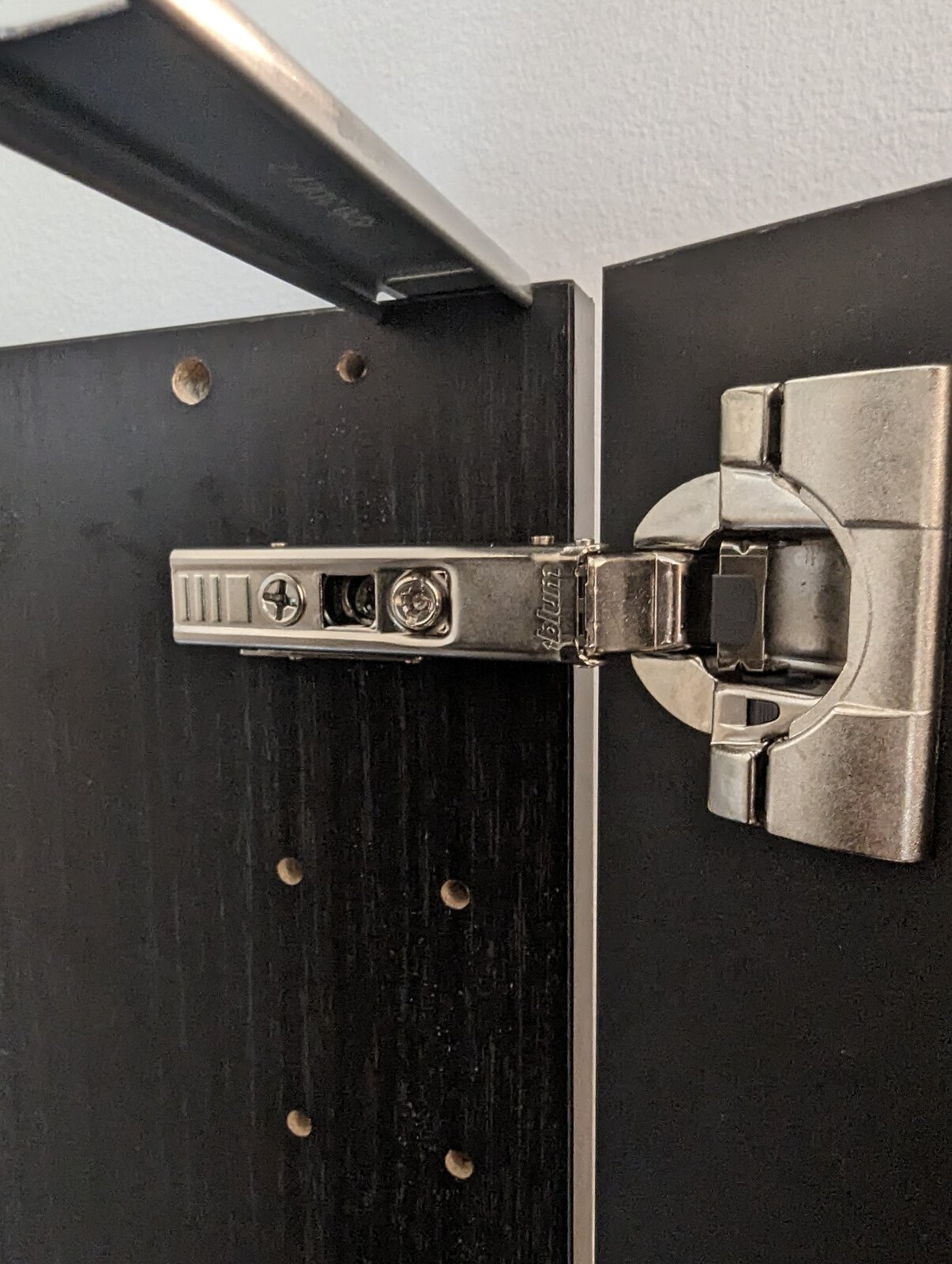

Hi!
I've installing some IKEA Method kitchen units as alcove cabinets either side of my chimney.
All has gone well up to this point, but I just can't get one cabinet door to line up. I've tried all the adjustments but it's still nearly 10mm out of line!
Everything is true and square, any tips as it's driving me mad and I will forever see it?
Thank you!

Door lines up if held without hinges attached?
it looks like youve racked the carcase when putting it in
check the carcase front to back and side to side, youve twisted it in one of those directions
You need to wind in top hinge and wind out lower hinge but before that level the cupboard on right and reverse on left hand door, level shows it out of level.
Show us a level on the side of cupboard?
